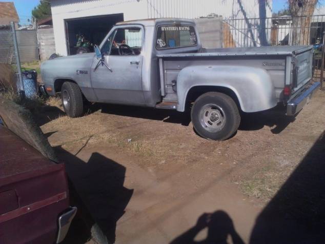

Here is a pic of my $650 project truck!
Man ! That look's "solid" ! Look's like the perfect foundation for a good build . Then again , I guess I am a lil partial to trucks with steps and rear fenders . lol
$650? You stole that! Build the engine and leave it looking like that and surprise a lot of people!
Thanks all! Yes it will probably keep the patina look for a while, probably until everything else is done. Im wanting to widen the rear 7" steel wheels to 10". maybe lower it 1.5 to 2 inches all around.
