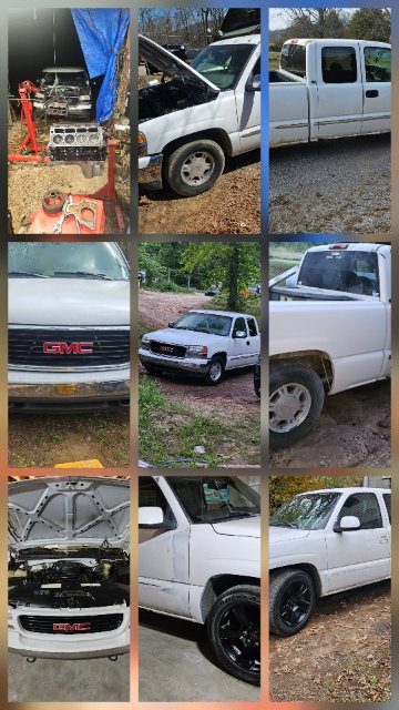

So i just put together a 5.3 and put in truck got everything hooked up and when cranking ,sounds like timing is 180 out, pull valve cover and confirmed #1 piston at TDC and #1 intake and exhaust valves closed so that should be compression stroke. What am I missing
