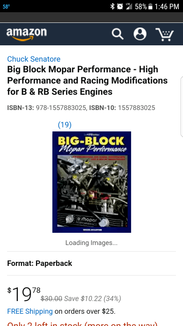

I'd recommend this book, lots of great info. Going off of what I learned from this book I was able to port my factory 452 heads to support a .550-.600 lift cam.

You are all right. I am very budged at the moment and took the engine apart. I looks really clean inside that I'm just going to put it in my truck how it is for now and save up for the parts. I did order the book because I need to learn more about big blocks and all the stuff You guys told me really helped.
