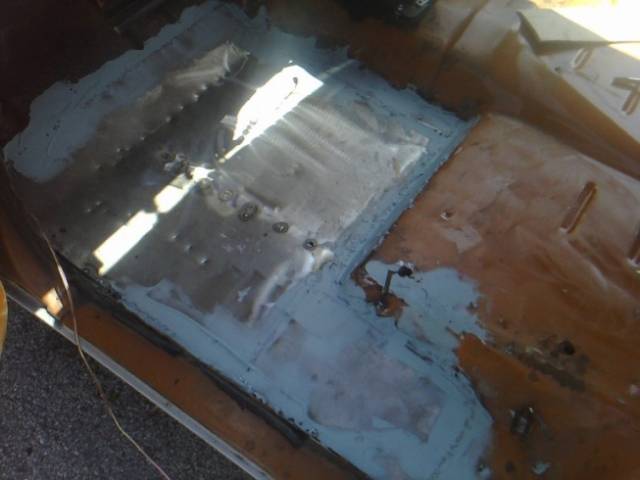

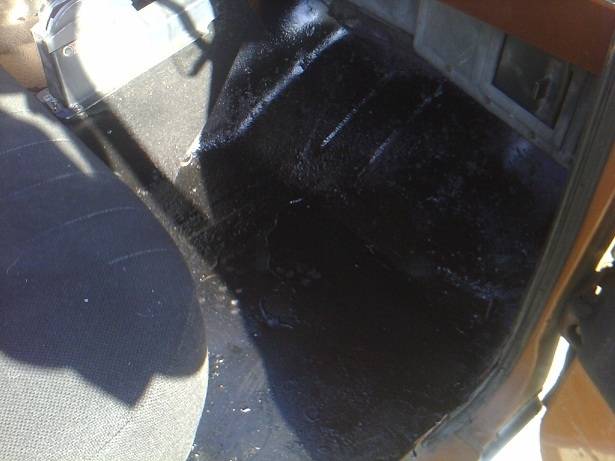

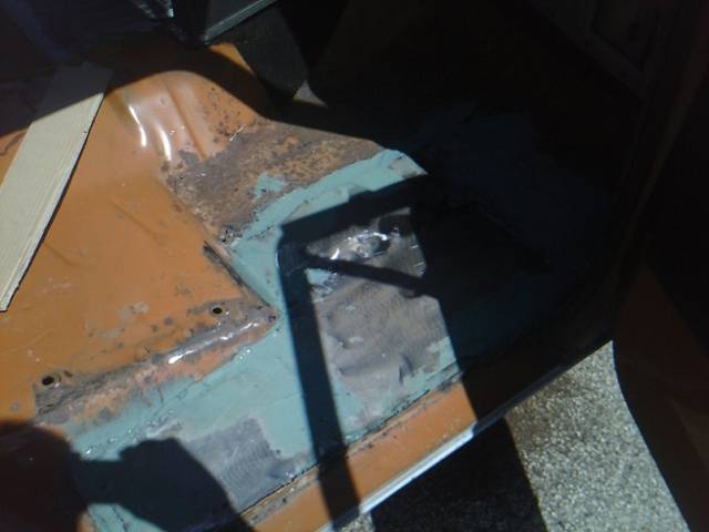

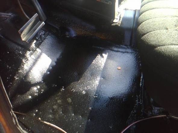

Ended up just using some 18 gauge sheetmetal to get the job done. Total cost - $28 for sheet metal and about $10 for some duraglass/filler. Then sprayed on some 2-part urethane bed-liner
