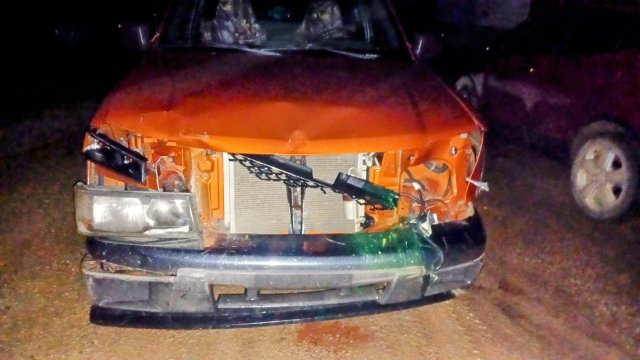

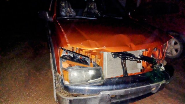

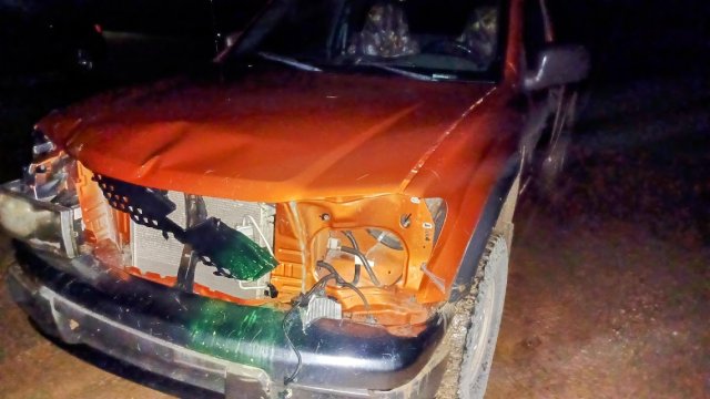

My daily driver is a 05 4wd Colorado. The week of Thanksgiving I hit a deer on my way home from work. My insurance company totaled it, so I bought it back. I started collecting parts and started on it today.
I found a bumper, grill, lights and a hood at one yard. A LH fender from another yard. I ordered a radiator and condenser from one of my suppliers. I took it to work and started pulling it apart today. I have the new radiator and condenser in, I repaired the fan shroud (cracked), refilled the cooling system. I had to order a A/C line (it had a split I didn't see) and the brace from lower radiator core support to the hood latch on the upper radiator core support. It's running again and I have a couple of things to remove, then it's reassembly time
