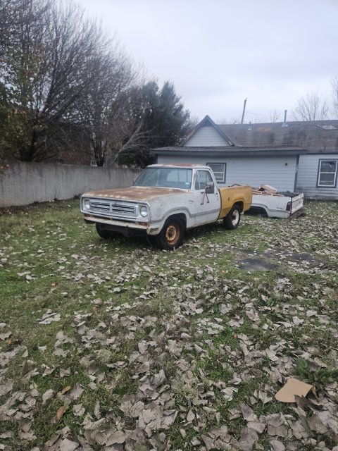

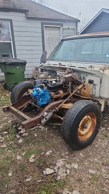

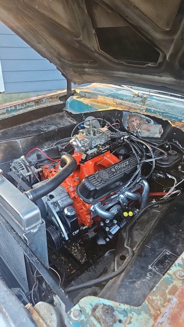

Hello everyone! Was wondering if anyone here successfully installed A body headers on a d100. I have a 73 d100 has a 360 that I'm currently working on and I have some summit racing headers off my 69 valiant that I'm not using. They do hang low for the steering link on a car so I'm pretty sure I know the answer, but I also have some doug's d453 that are on my valiant currently and they do hug the block pretty well anyone know if they'll fit a 73 d100? I wouldn't mind putting the cheaper summit headers back on my valiant and putting the Doug's on my d100 if they'll fit. The d100 has the 360 that i do plan on putting into my valiant anyways.
I appreciate any info
Sam.

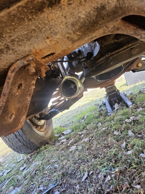

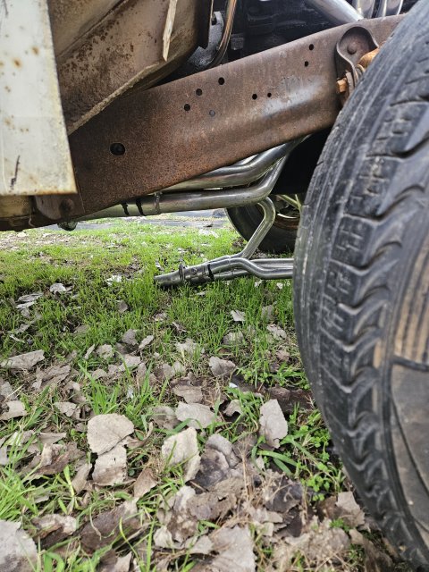

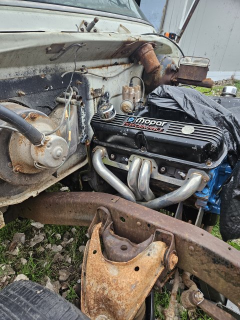

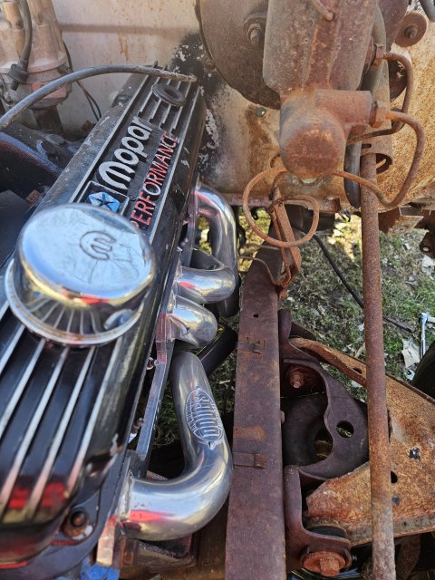

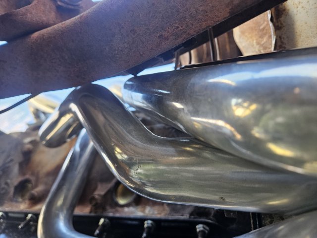

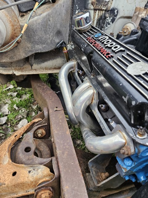

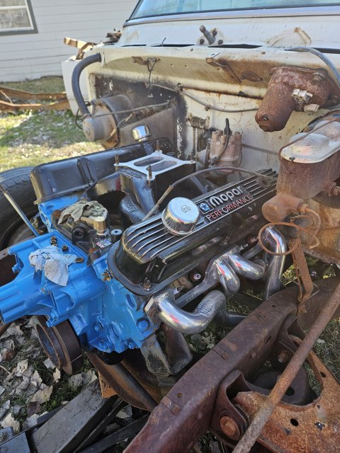

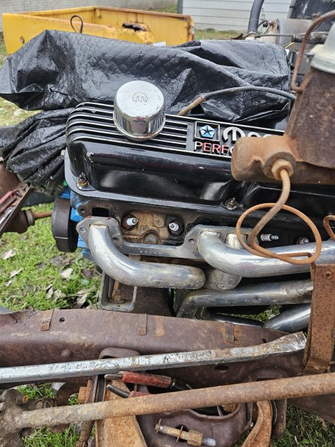

Usually, car headers don't drop down far enough for truck applications, but, that would depend on the brand and type of headers.
The summit brand passenger fit perfect. Driver side now so much, took some measurements the driver doug header should work. I'll post an update when the weather gets better so I can pull it off my valiant.
