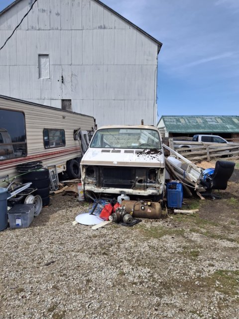

Have done a few basic swaps, couple Hyundai ponies, sbc to sbc, sbf to sbf sbf to fe, no mopar, now that it's thawed out enough to open the bay door, I Can pull the 360, the 440 donor was prepulled by the owner, so any heads up, hints tips etc for my first sbm to bbm swap would be gratefully accepted
79 tradesman, currently has a late 60's early 70's 360, due to the 1979, 360 externally combusted
Putting in a 75 440 out of a new Yorker
