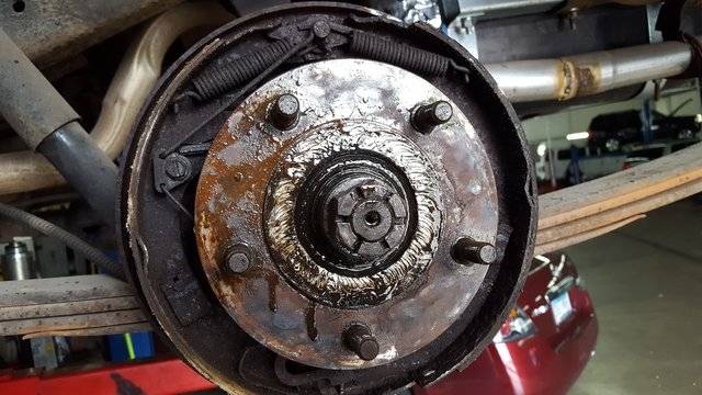

A friend has his Jeep in my detail shop. It needs wheel cylinders - no brake pedal and leaking. I want it out of my shop, but he can't get the drums off. Anyone know the trick to get rear brake drums off a 1969 Jeep Jeepster Commando? I need the space and will do it for him just to clear my shop.

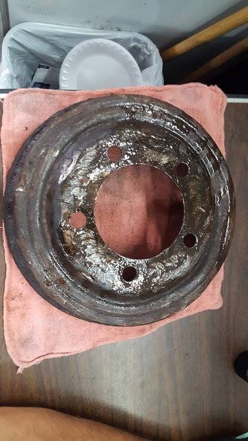

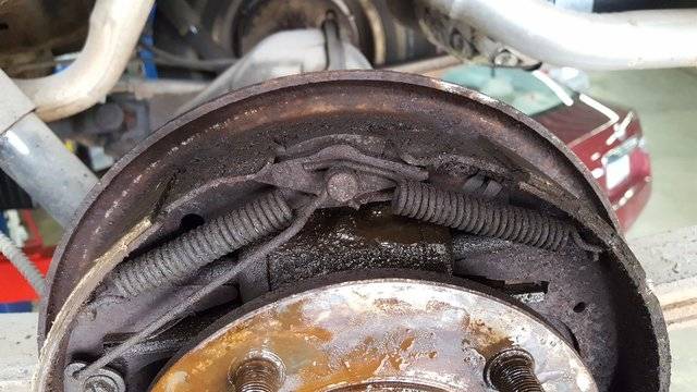

Okay, so what I found was the nut had nothing to do with it. There was a small lip the size of the drum face that was about 6" around. It was a tight fit. I beat the shit out of the drum until I had blisters on my hand. I tried using an air hammer, penetrating oil, etc... I finally got it to start lifting up but the studs appeared to be holding it in place. I figured studs are cheap and easy to replace so I screwed a nut onto them and pounded them in. Once the fifth one loosened up the drum came off in my hands. Going back together the hub was such a tight fit I had to use washer and lug nuts to hold it in place and lightly air hammer the drum over the lip. But it's done and on the road. Needed a wheel cylinder, shoes and a drum. Of course the line twisted off and I had to replace a small section of line as well.
I was thinking the drum was held onto the hub by the wheel studs, never would have thought it was a press fit onto the hub.
