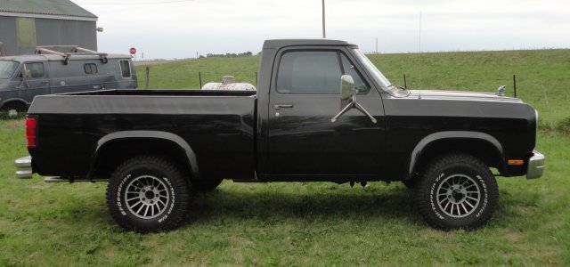

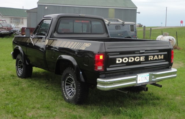

I had an 87 W100 Short box with the same size tire. I used stock wheels.
I wish I could find a set of those wheels.
