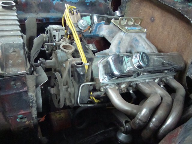

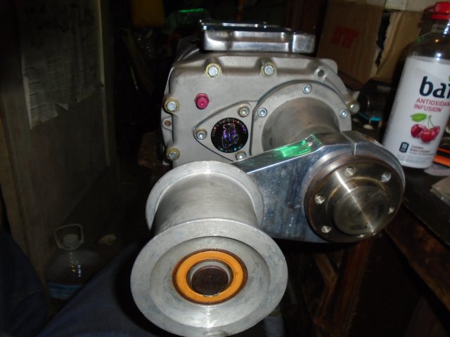

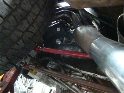

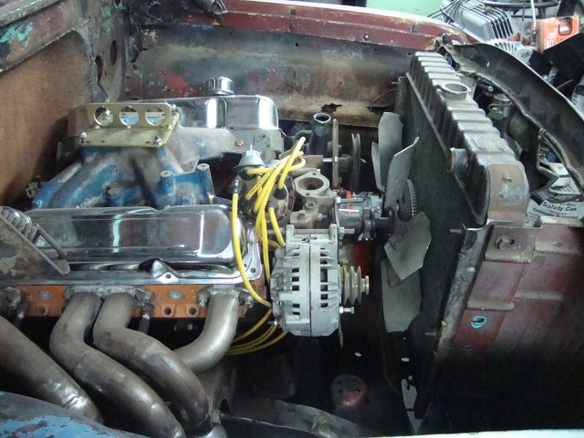

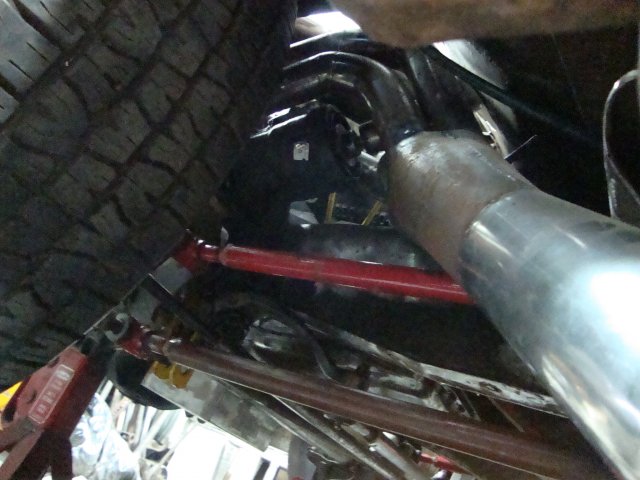

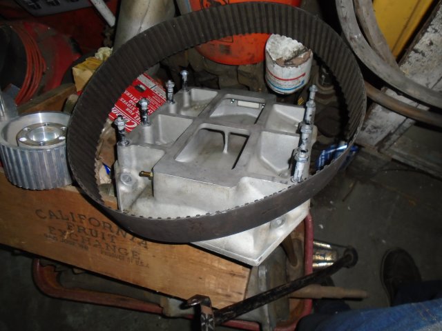

well i've built my own headers with 2''primaries on my 60 d100 with a rb stock stroke n i min bore job . but the intake has a huffer pushing air through it . i will fix 3'' exhaust on to it . and if it wasn't being blown i would seek out 1 3/4 or 1 7/8 primary tubes into 3'' exhaust for my hotrod driver .
