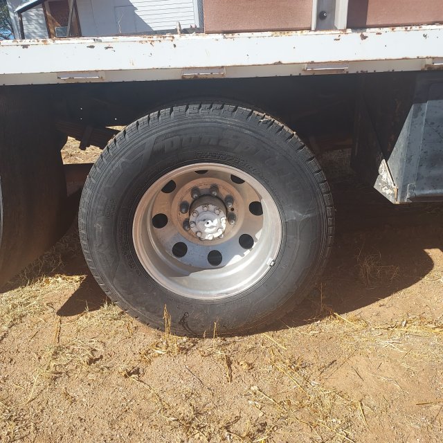

I upgraded my '85 pickup and '90 flatbed to 16". In bigger cities 16.5" tires can be found. However I found that in smaller towns, especially in more rural areas, while traveling about, that 16.5"s are like dinosaurs, nearly extinct. Attached is a pic of Chevy Alcoa 10 hole alloys with enlarged center register and enlarged lug holes to accept a shank style lug nut. You were informed correctly that Ford (1999 and prior) and GM (years unknown) have the same 8 x 6.5" mounting pattern.
Forgot to add that I've never encountered a 16" wheel that interferred with the front disk brake caliper on any Dodge dually originally equipped with 16.5" wheels.
Another clarification regarding member who suggested using 17" dia. wheels. Most factory supplied 17" wheels from Ford and Chevy have the lug pattern of 8 x 170 mm instead of the 8 x 6.5" (165 mm). Unsure if/when Dodge changed their mounting pattern.

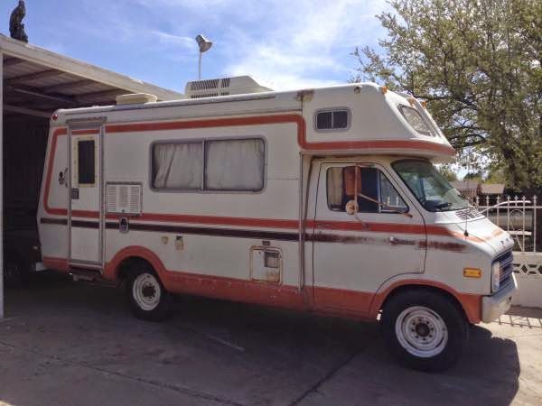

Until Casca2525 submitted a pic I presumed we were talking about motor home with a dually rear and corresponding 1 ton front suspension. Upgrade may be more difficult if OP's vehicle has the dually rear and 3/4 ton front suspension. There would still be aftermarket wheels available with the correct 8 x 6.5" lug pattern. But not sure about possibilities of using Ford or GM substitutes on the lighter duty front end.
There was no change between 86 and 83. I haven't tried the wheels from 76 to 83 yet. My class C is all one ton.
