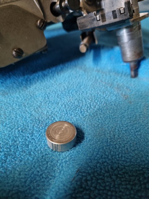

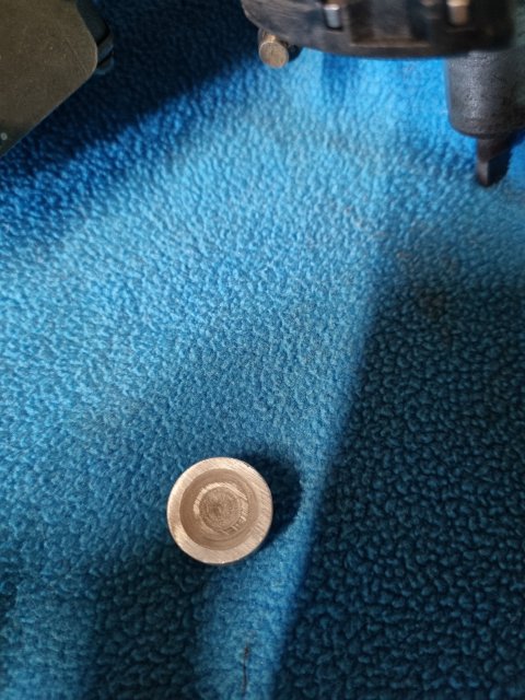

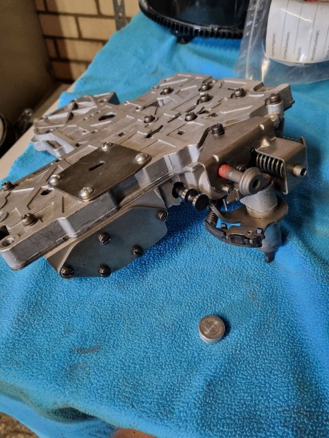

Hi everyone,
I am rebuilding a torqflite A727 for a 1977 dodge w200. And i cant remember where this part goes (see photo), im pretty sure it came out of the transmission. Looks like some kind of aluminum spacer to me.
The part doesnt show in any of the exploded views.
Thanks in advance.
It goes in the governor housing. On the output shaft. There should be two of them and a spring. That our you punched a plug out in the valve body.
Take lots and lots of pictures if you are attempting valve body disassembly.
