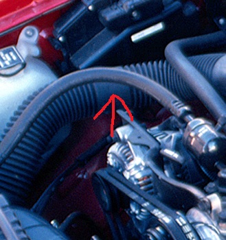

I read in another post how much fun your Dak is. Get a Hughes ported throttle body, Mopar PCM and a shift kit. Major kick in the pants! Oh and, move your IAT to the plastic intake hose (block off the intake manifold hole of course), it fools the PCM into bumping the timing up a few degrees thinking the intake air is cooler than it is. Oh and as Im typing this Im remembering all kinds of cheap mods/cheats. Oblong the holes on the TPS and play with it. It changes a sluggish pedal instantly. Damn, I should probably do a sticky?!
I will be in touch about the intake, and I am still trying to find a stock V8 T.B. so I can mod both pieces at once myself while still driving the truck. ( I'm on a limited budget ) Any other mods that I can do myself that you know of, let me know. I do have a new air temp. sensor to install somewhere in the air intake system, just not sure where I want to put it yet. Oblonging the T.P.S. sensor is a new one, I like it. I used to be an auto mechanic, so I have all the tools I need. Thanks again for you knowledge & help Scoots.

Heres a pic of where I located many IAT's to:

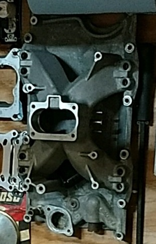

I found one of these in Pep Boys years ago and held a 2bbl TB up to it before, it doesnt line up perfectly with with a little machining could adapt a stock TB to 4bbl intake I believe.
Yeah I wasnt referring to LA but I see now that Indy intakes seem to fit Eddy and Mag heads, it used to be the Indy intakes were for Indy heads. Although, the site doesnt say that 100%. This is the kit, pricey for sure, you have everything needed, no guesswork and trust me, taking a stocker off and using anything else takes parts you wont have.

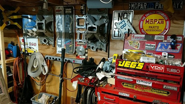

That adapter is Mr Gasket and I hear what your saying but, its nothing doubling up a gasket wont handle. I just grabbed it because it was old school cool, mainly for the parts wall in my shop. ;-)
