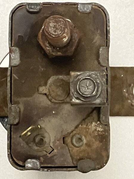

The truck relay, this looks just like the one I bought.
These have mounting tabs on each side.
At the bottom of the relay, there are 2 spades. MY old relay only had the one on the left. Oddly, I didn't have any wiring going to the neutral safety switch on the transmission. The NSS terminals had a coat of greasy dirt on them indicating that there hadn't been any wiring there in awhile. This is odd because usually, if there is no signal from the NSS, there are no backup lights and the starter won't be engaged. The truck has always started fine when the battery is up. It had a 4 speed in it when I got it, I converted it to the 727 to make it easier to drive around the back yard. I either had it wired and it came off or it never had it and somehow still started without it.
You can get the starter to spin with no wiring from the NSS but you need to "ground" one spade on the relay, the one on the lower right.
Again, my old relay was missing that spade so it is a mystery as to how it started all this time.

4wd trucks with manual transmissions were originally fitted with slightly different starter relays. They lacked that spade at the lower right corner:
Instead, they had a flat metal section that attached the terminal to the case of the relay to ground it and complete the circuit. I didn't look real close at mine when I pulled it but there it is.
It seems like the new ones work fine but need that lower right spade sent to ground somewhere. A short wire to the fender liner should work.

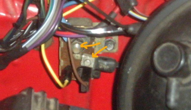

The yellow wire does not get grounded. Here is the relay in my Charger:
The arrows there point to the two terminals that I bridge across to start a vehicle when turning the key does not work. This bypasses the function of the relay.
The brown wire at the lower right corner is from the neutral safety switch, right? Manual transmission vehicles didn't have that feature for many years so you get the relay like my truck had:
As long is the relay is properly bolted down, it is grounded so the corner piece is also grounded.

Brown wire to the relay supplies the ground. On an automatic car, this brown ground wire comes from the Neutral Safety Switch. Manual cars did NOT have a brown wire, ground was supplied by the "case ground" of the relay case to the firewall.
Yellow is +12V start signal, from the ignition switch when turned to the "start" position only. (auto or manual transmission)
