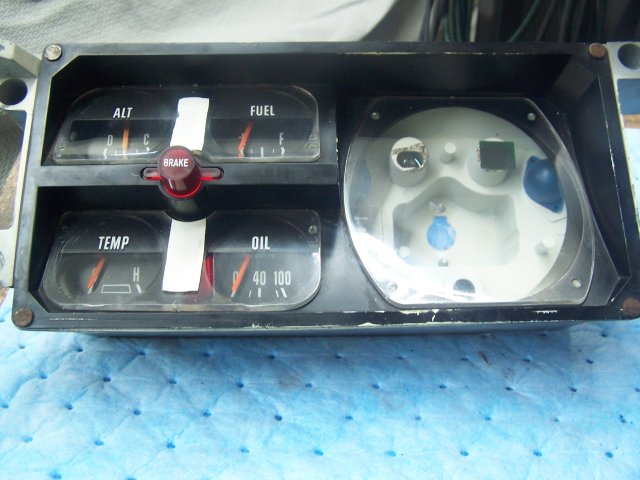

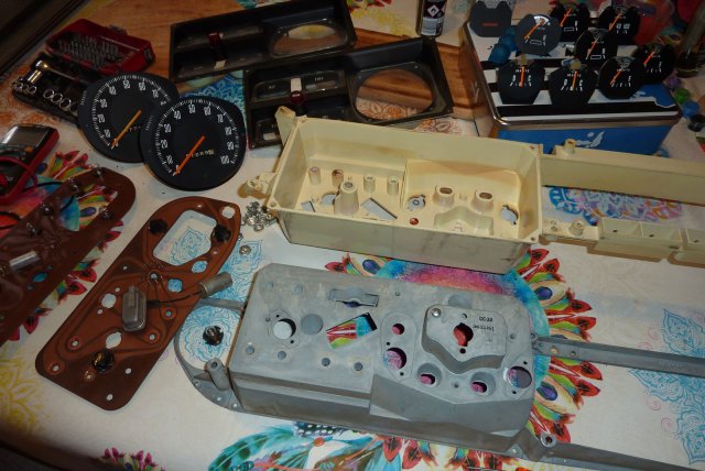

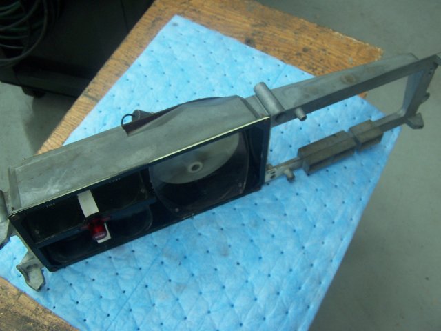

The 75-76 trucks got the metal gauge panel. Dodge went cheap charlie when they started with the plastic panels. (I believe 77-80) IMO, the metal ones are best and they interchange with the plastic ones perfectly.

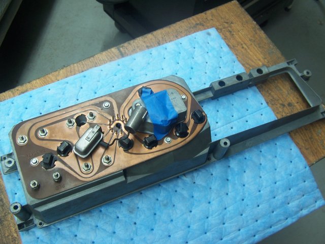

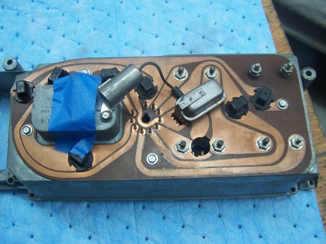

Here are a couple pics of one I have. It is complete except for the Speedo which has been sold. They are getting extremely hard to find these days as the amp gauge has melted most of the plastic ones.
I can say plastic panels started in 1976. The blue Dodge is a 75 and it has a metal panel. The two orange are 76 models and they have a plastic panel

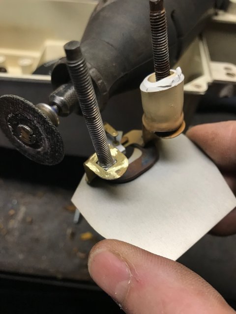

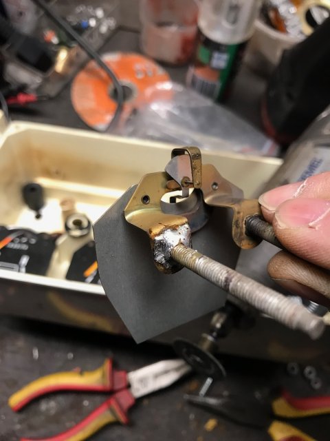

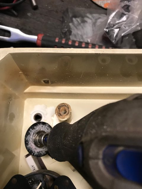

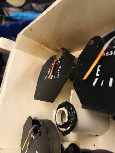

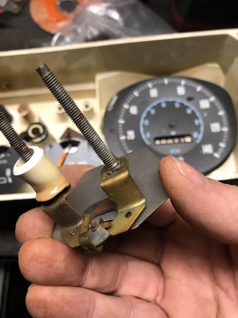

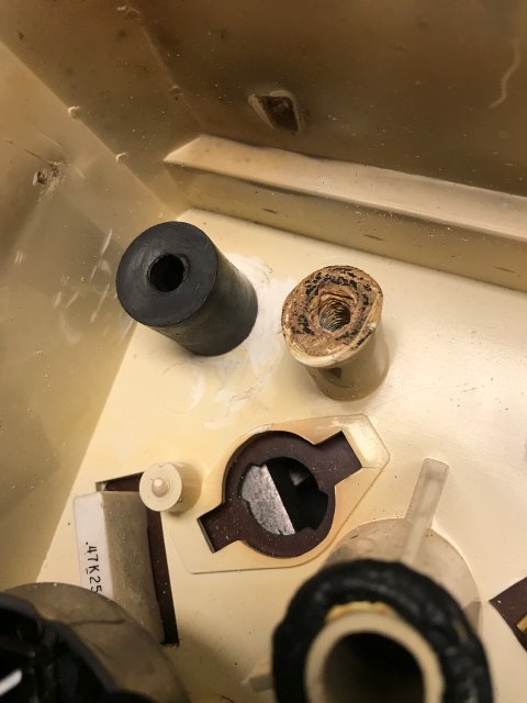

Plastic panels are not so hard to repair. But the first thing to do is to remove the cause of the heating. The heat comes from the poor connection between the gauge and the screw. Tin soldering can solve the problem. Silver grease on lugs and nuts can help too when wiring back
