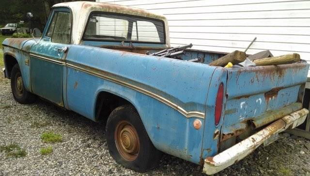

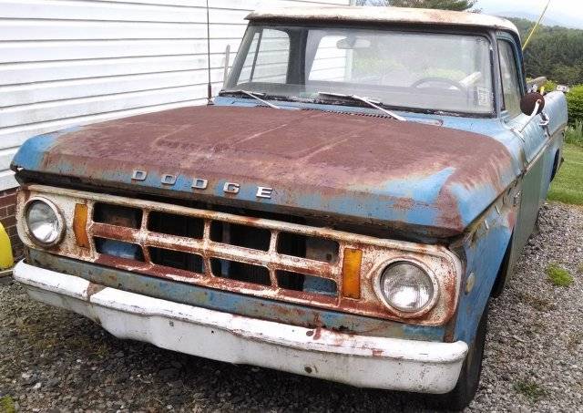

It doesn't look like much right now, but it's pretty solid and runs. This will go great with my D400!
I need to reduce the image size, grrr!
I've been wanting a good candidate for a rat-rod type project. I believe this one might work. I think it's solid underneath, but I will have to get it on the lift before I make that call. There's a '68 383HP at the house that's been begging me to put it back in a Dodge pickup. I may just have to do that...

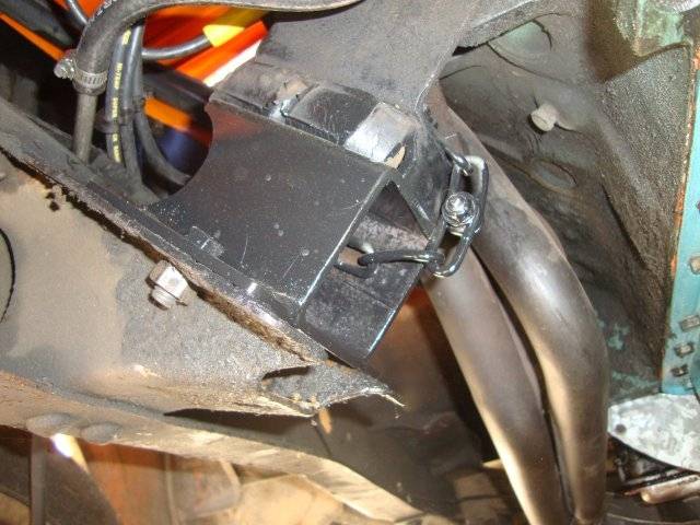

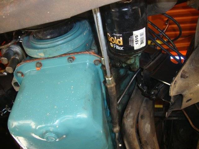

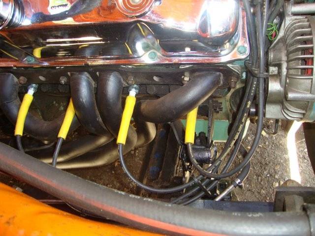

sweet man , that what i put in mine 64 , here some mounts pics , using factory frame . and motor motor brackets and isolators n oil pan . headers are w series rb .
, my 69 adv had a 383 stock , went 440 on that one . but thats what wrecked it .
Excellent information! Is that a "truck oil pan"?
Factory motor mounts or custom built?

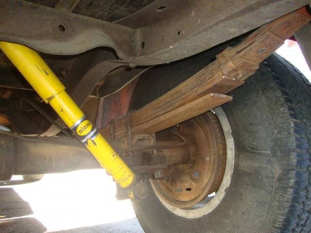

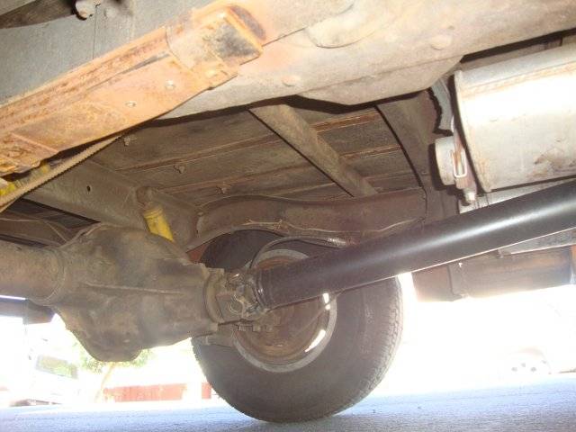

ya , big truck , motor home straight axle type same as my 69 383 had . my ramcharger i thought a rear sump . there was a member on fbbo or fabo that had an 440 engine for sale with that pan also . the p/u is a stick ? you'll be cutting the bell housing mount crossmember out . need to pull a brace back to keep the spring mount from twisting the lower frame , just a flat plate between the c of the frame welded in . but thats with stock front suspension . do some beef up on the rears springs it will handle better , i used some b350 passenger van rears to make up my rears , put a 9 1/4 354 loc'r in ti as well . my p/u had the huds n nuts r/e before . and soon front disc package for wow factor . so it will stop after all the go stuff , lol . more ramcharger parts .
Good information. I've been told that I will have to switch the oil pan to get the big block to sit correctly. I am no-where-near ready to worry about that though.

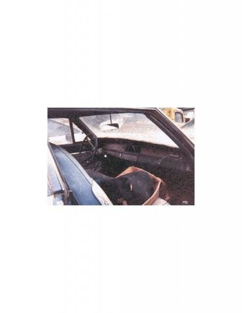

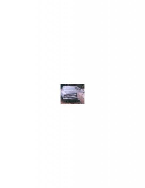

started a kid out in a 68 rr coupe roller that i had , sold it to him for his ffa sheep sale funds . hope it did him good . cut round rear wheel houses , but rust free . great starter muscle machine . sorry abouit the size , had my sister help me store pic fills once .
